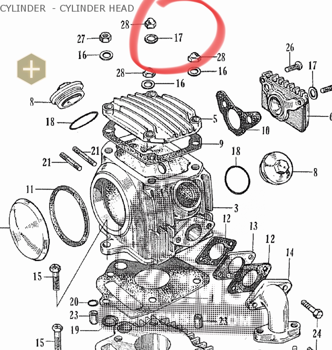

Sidenote: Please replace the generic bolt of the oilpump for OEM, don't cheap out (or get lazy) on a build like this. And add the copper washer under the headbolt that has the oilguide.

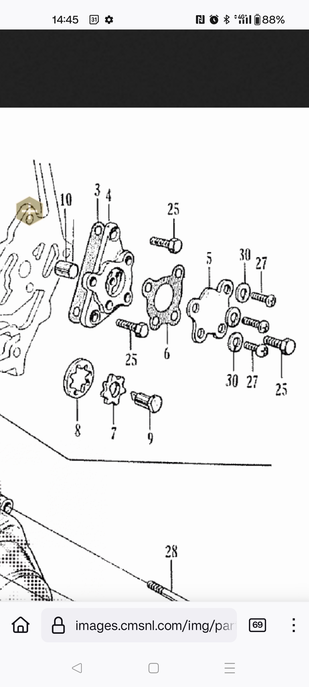

About your sidenote : all the bolts fixing the oilpump are original, this engine never was open before, a picture when I opened it :
Sorry but I don't understand what is the copper washer under the headbolt that has the oilguide, this one ?

Berichten: 1735
Re: Onoplosbaar koppelingsprobleem op een Z50M
Who knew! :oops:
Berichten: 1735
I think he means #17
Berichten: 2046
ildert schreef: 03 okt 2024 14:46 Who knew! :oops:
Whoops, my apologies. Never seen that.
It looks like Z50A also has the new type pump that has these bolts. There might be others. You just keep learning with these old Honda's.

Thanks gebrandicus, no problem, we learn every day about our beloved Monkeys !
And you were right about the copper washer under the headbolt, I corrected its position ;)
